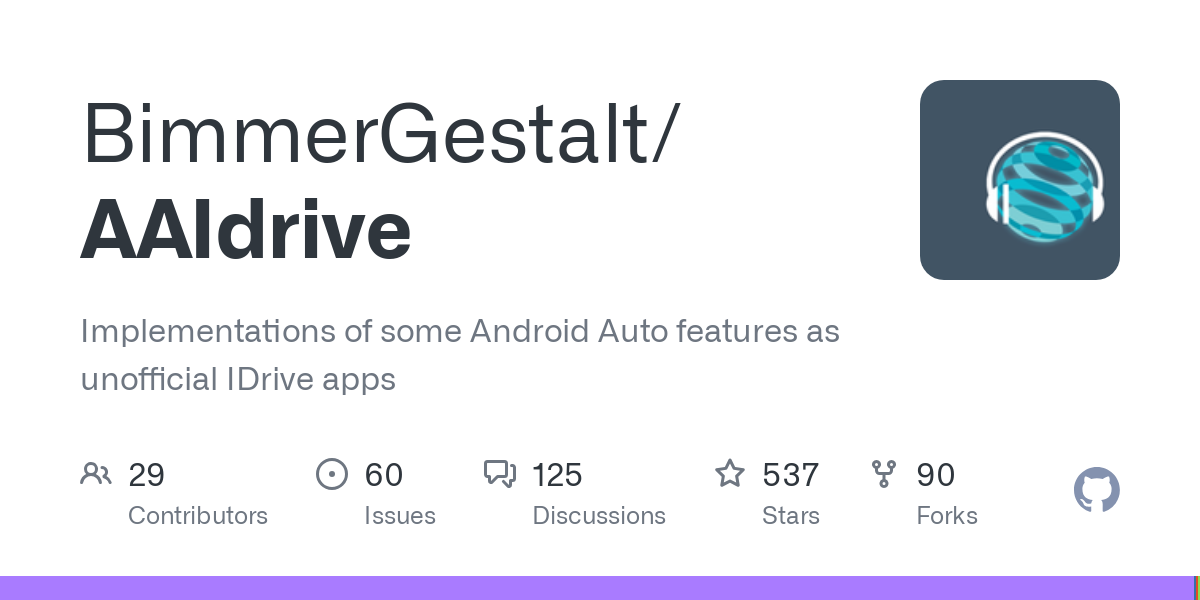

    Vermutlich wird die Alternative App Androidautoidrive als APK somit auch nicht mehr laufen.
    GitHub - BimmerGestalt/AAIdrive: Implementations of some Android Auto features as unofficial IDrive apps
    Implementations of some Android Auto features as unofficial IDrive apps - BimmerGestalt/AAIdrive
    github.com
    Zitat
    This app requires that the BMW Connected or Mini Connected app for your car is installed and can successfully add the Connected and Calendar entries to your car's Connected Apps menu. The new My BMW app seems to interfere with BMW Connected and is not supported
    Vielleicht kommt ja noch was?
